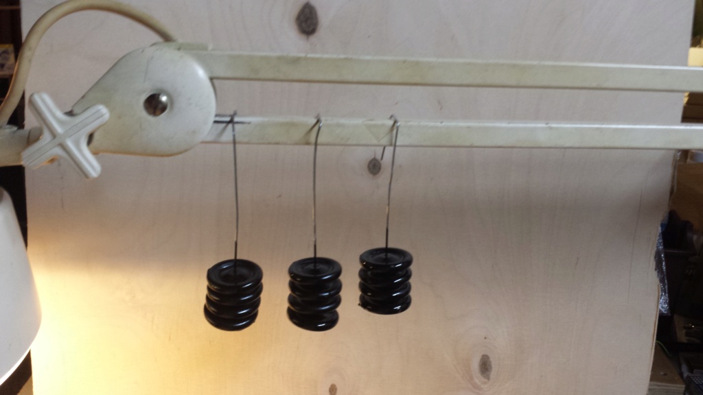

black-painted wheels
I was bored this afternoon.. and decided to paint some more of these wheels. Actually.. I "dipped" them..
First; I drilled-out their hub-holes from .055" to .067" to fit common/sturdy .062" (1/16") diameter K & S brand music-wire.
The "paint" is a Pactra oil-base type; labelled "Odds and Ends" enamel.
I used the paint earlier this year; brushing it onto these same wheels. I was happy with the finish.. but I don't know how it will hold-up to glow-fuel exposure.
My "Rare Bear" 1/2A profi-speed model has been recently retro-fitted with a pair of these wheels that were "brush-painted" with this Pactra paint.
Today I decided to try "dipping" some wheels into the paint. After drilling-out the hubs.. I used paper-clips and plastic "coffee-stirrer" (straws) to stack a few wheels for dipping-into the paint. The coffee-stirrer/straws were cut-short with nail-clippers to approx. 1/8" (3mm) which was enough of a gap between the wheels.. to keep them from touching.
Here are the dipped wheels (drying..). I'm sure that they'll be fine for "knock-around" use..
Incidentally... I save paper-towels that are not particularly "soiled".. for re-use/re-cycle in the shop. They're quite handy for cleaning-up spills or drips.
Re: 1/2A size model-airplane wheels
Roddie. I notice some of those wheels have a "drip" of enamel on them, and will dry that way. When I dip items I usually take them outside and "fling" them around to shake off any excess paint so they don't develop drips. If you have time on your hands, you can also continually rotate the painted item to spread the paint evenly over the surface as it dries, but this can be tedious with slow-drying paint.
