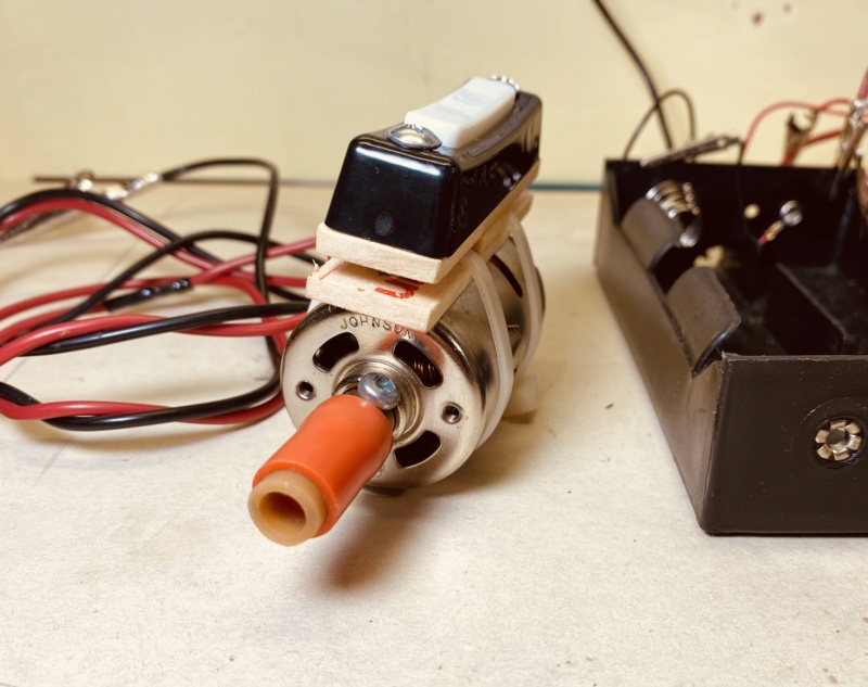

One more home made one for you Yabby…
Half A Starter Question - Page 2 7c8c0410
These little can motors can come with different windings depending what they were originally intended to do….. Mine came out of an old cordless can opener with two
Ni Cads (2.4 Volt)….I think old cordless screwdrivers are low cell count too…. They don’t care if you up the voltage on them somewhat, Will just deliver more torque….I have a holder for four D batteries for a max of 6 V….I start .020’s on three of the cells, Just jam the alligator clip between cells three and four…. .049’’s need all four….. I give it the minimum power it needs to turn engine over so if loads up too much it will stall the starter…. And hopefully minimize the chance of breaking something ….I made brass thrust washers for those I intend to start with it…
I saw the doorbell switch idea here on CEF…. I can’t remember whose or I would credit them….Other than that just a gear, a plastic tube, and piece of surgical tubing to engage the spinner….
Posts : 684

Post  Yabby Mon Jan 30, 2023 3:08 pm
rdw777 wrote:One more home made one for you Yabby…
thanks Robert! cheers sunny Im glad I asked the question as so many people have been able to post help with how they have made them from readily available cheap parts!. I like the doorbell as the button. Smile being able to change the voltage as a protection for the engine is a great thing. Another example of neat home engineering that works. I can see that I will be able to make one now and the photos show the relative simplicity of them. which is the great thing, as they are hard to get and quite expensive. Its great seeing all these ways of making one, and also all the people that do use them. I wasnt sure if they were an OK type thing or not, but given all the people that use them, I will certainly use one and just take the advised precaustions.
