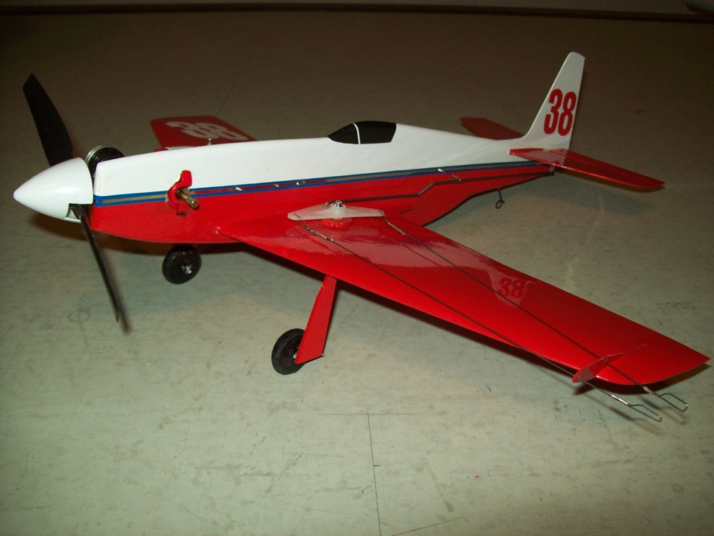

 duaneh's 2023 CEF Run What Ya Brung Unlimited Speed Contest Build Log  Empty Finished
Post  duaneh Mon Sep 11, 2023 12:13 pm
Mounted the engine, and it looks like there is nothing else left to do. I'm calling this one done.
15-3/4 in. span, 51 sq. in. wing area, 5 oz. weight.
 duaneh's 2023 CEF Run What Ya Brung Unlimited Speed Contest Build Log  100_4733
 duaneh's 2023 CEF Run What Ya Brung Unlimited Speed Contest Build Log  100_4734
 duaneh's 2023 CEF Run What Ya Brung Unlimited Speed Contest Build Log  100_4735
In order to reduce the offset thrust, I sank the engine into the fuse as far as I could while leaving access to the mounting screws.
 duaneh's 2023 CEF Run What Ya Brung Unlimited Speed Contest Build Log  100_4736
The torsion wire gear follows standard RC practice. I will need a lot of flex since all landings will be on grass. The wire is retained in its groove only by clear silicone.
 duaneh's 2023 CEF Run What Ya Brung Unlimited Speed Contest Build Log  100_4737
It's about the same size as my backup plane, Miss America.
 duaneh's 2023 CEF Run What Ya Brung Unlimited Speed Contest Build Log  100_4738
