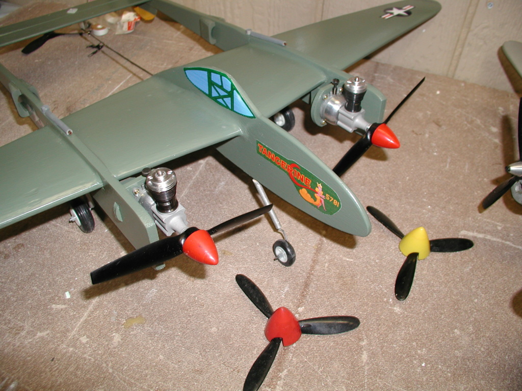

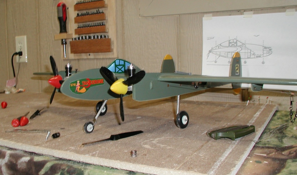

Cleaned up those engines, painted the tips of the P-38's fins, and rigged some lines.  Cases loosened and drained, backplates stay on.  Lot's of CW/CCW rotation while immersed, compressed air blowout.  MMO protected.
New P-38 profile scratch build log - Page 4 P1016523
New P-38 profile scratch build log - Page 4 P1016524
New P-38 profile scratch build log - Page 4 P1016525
New P-38 profile scratch build log - Page 4 P1016526
New P-38 profile scratch build log - Page 4 P1016527
Just the natural fall of the lines, follows the taper of the wing.
New P-38 profile scratch build log - Page 4 P1016529
New P-38 profile scratch build log - Page 4 P1016528
New P-38 profile scratch build log - Page 4 P1016530
Not glued in, got to form the ends and secure.  Swivels will go on the handle not the airplane.  I have the more appropriate safer double lock keepers but I like these.  I have used them on larger airplanes without a problem.
One way or the other, there will be Dacron. My shortest twisted steel lines are 52' which will drag this plane down. I'm thinking 30' - 35' Dacron.

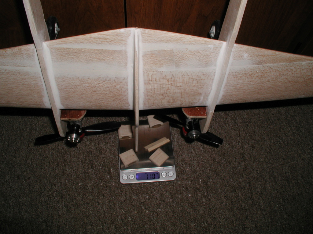

I was wondering how much weight three coats of sanding sealer and two coats of paint plus other stuff I hung on it would add.
1107/1227 oz.

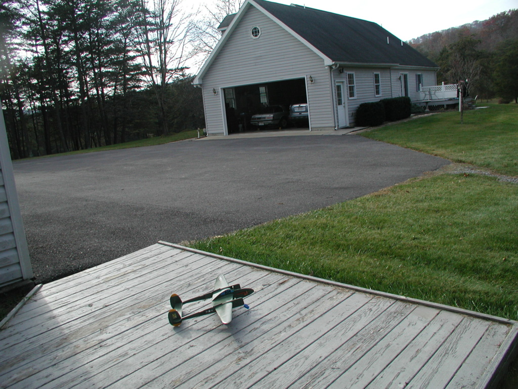

Well I thought I was done but debated whether or not I should clear coat it, my son thought I should so I did.  Not sure I like it, no longer satin but a shiney plastic airplane look.  I'll let it cool off for a couple of weeks then put the engines back on.
New P-38 profile scratch build log - Page 4 P1016549
I have taken 1/2A airplanes off the driveway before, but it's a tight circle.  Picked one out of a tree.  But the electric Cox Bearcat did well there.
New P-38 profile scratch build log - Page 4 P1016550
New P-38 profile scratch build log - Page 4 P1016548

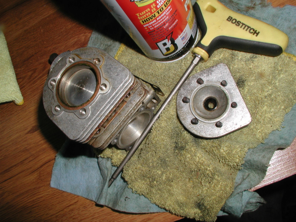

While waiting for the plane to dry I removed the head on the Cox/Rhino/etc engine and thought - Ain't that something, my fathers favorite expression although he used better English.  No combustion.  I don't think that it was ever ran.
New P-38 profile scratch build log - Page 4 P1016551
New P-38 profile scratch build log - Page 4 P1016552
New P-38 profile scratch build log - Page 4 P1016553
The other engines were not quite so pretty:
New P-38 profile scratch build log - Page 4 P1016554
New P-38 profile scratch build log - Page 4 P1016555

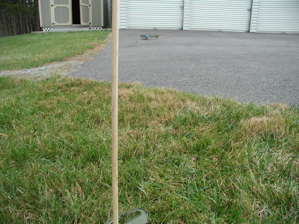

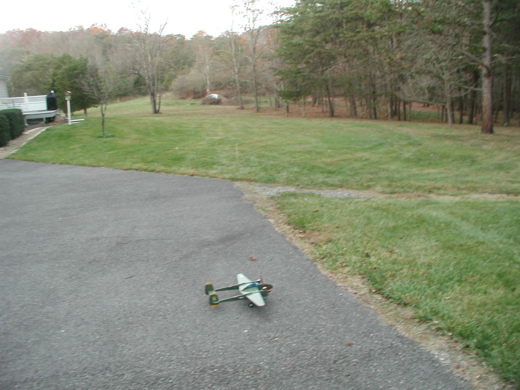

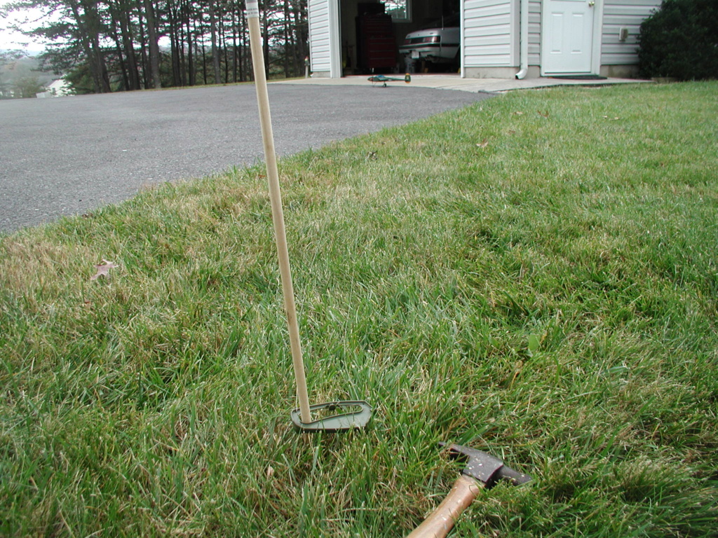

So, "just for the fun of it" I drove a stake in the ground to secure the control handle and using my previously mentioned olive drab Dacron 26'.5 line checked distances to potential obstacles.
New P-38 profile scratch build log - Page 4 P1016571
New P-38 profile scratch build log - Page 4 P1016573
New P-38 profile scratch build log - Page 4 P1016572
Ok, it's to close to the garage so I moved the stake over and down about four feet and checked again.
New P-38 profile scratch build log - Page 4 P1016574
New P-38 profile scratch build log - Page 4 P1016575
New P-38 profile scratch build log - Page 4 P1016576
New P-38 profile scratch build log - Page 4 P1016578
New P-38 profile scratch build log - Page 4 P1016579
I think I could do it.  Starting at the extreme edge of the driveway I think it would get airborne before I hit the grass, if not the worst thing that could happen is a tumble landing upside down.  Airborne?  The worst thing would be a stall over the asphalt.  Splinters..........
Fuel it up, let the engines run a minute or so with a final squirt in the inside engine and let it go.  Not to worry about that Dacron, it's in great shape and would hold, if I thought differently I would change it.
New P-38 profile scratch build log - Page 4 P1016580

Pretty short lines but your plane is fairly light best I remember so maybe it doesn’t have to fly too fast….Very rich settings and half the fuel gone maybe?…. Wishing you luck, I know you want to fly it Very Happy
Robert

Hi rsv1cox,
Beautiful P-38 ! Cox powered at it's best ! Cool
I used those rolls of dacron for decades. (max 33ft handle/plane)
Then I tried new 'fishing line' methods.
Same plane, at 42ft radius...Wow what a difference ! Slower laps and way more 'room' to manouver. Very Happy
(BW.049, my version of a Flightstreak, I have never flown a twin)
Good luck on the test flights.
I have also taken off standing at centre field, and hit football field goalposts, levelling off for landings...
Your results will vary... Very Happy

Thanks Robert and Dave........
 I really do.  I get that "just do it" urge, hits me spontaneously but I need to know the parameters first, I don't want to wrap it around a tree before I get a lap or two in.  Smile
The problem is I have to fly it in a restricted space, there is just no place around to fly C/L.  I might be able to go out to 30', we will see.  I have to take it off a flat smooth surface.
I might get out the stooge one day and "just do it."
