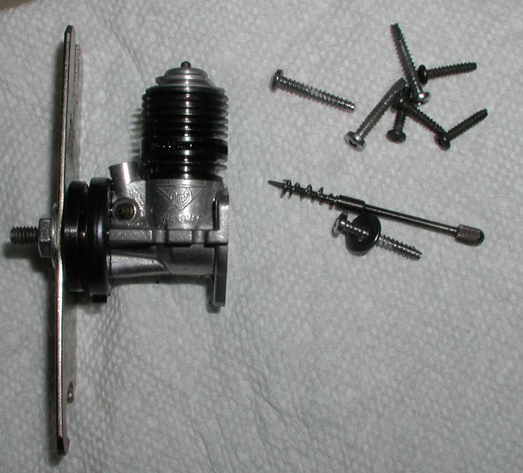

Took it apart, no heat required. (soldering iron on the self-tapping screws) It had been ran, some castor goo on the interior. Despite what the wing leadout indicator shows there is no throttle on the engine. I do have one I could use, thinking about that.

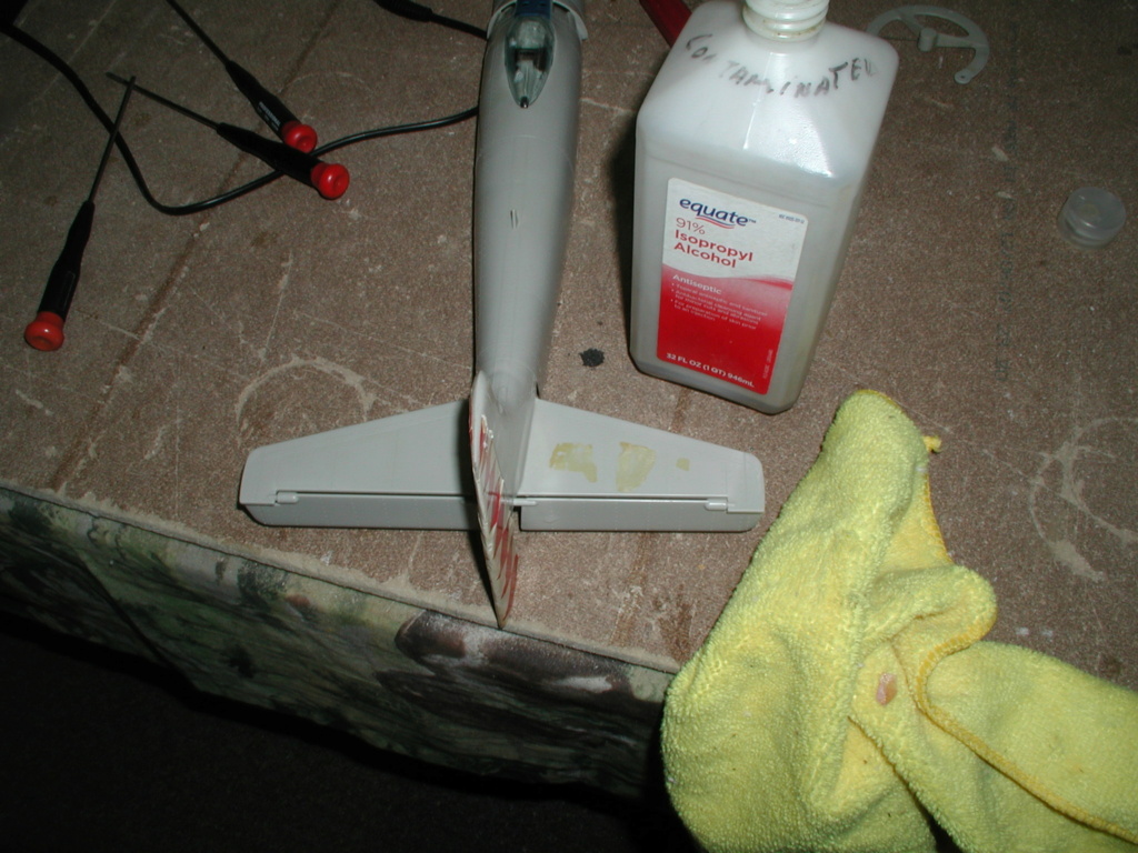

Whoever had it before applied decals that were either incorrect or misplaced and they had to go. A warm water soapy soak loosened the color enough to peel it off, Berryman's and 91% alcohol did the rest.

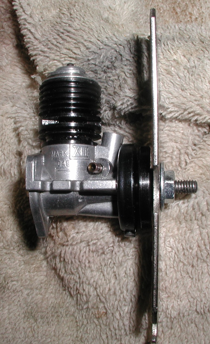

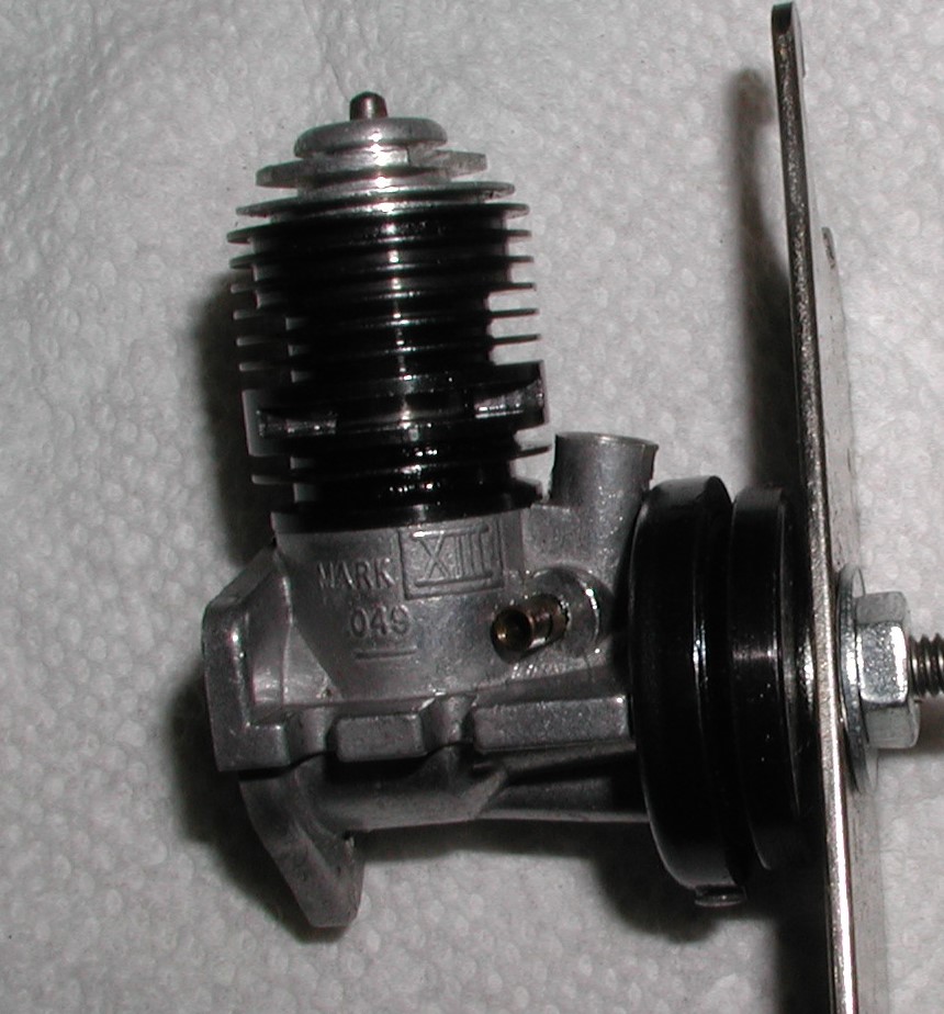

The engine and starter were castor locked, Berryman's and heat cured that. And yet another different Wen Mac engine case, I have never seen an off the shoulder designator design like this.
Different needle too. First one I have seen with a flat milled into the end. Position feel maybe.

The added trim probably created in the head of a 12 year old had to go. I replaced the orange paper backed wing tip trim with red vinyl electrical tape and removed the misplaced decals on both upper and lower surfaces of the horizontal stab.. I also substituted a throttled engine for the non-throttled version and replaced the broken fuel tank nipple with an aerosol straw cut to length and cemented it in. Progressivly larger drill bits up to 3/32" the diameter of the straw doesn't damage the plastic.. Overnight cure of the Testors.

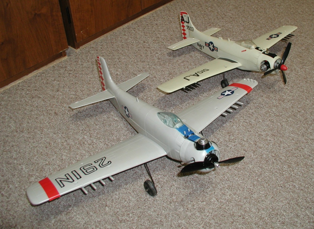

I took some comparison pictures with the Cox version. The Wen Mac model is bigger and heavier and has more features. The bomb release is a simple flexible release flap which a control line threads into, about the same action as the throttle control line. The plastic on the Cox version has yellowed over time, even the NIB protected example while the W/M finish has held up well. Elevator control exits from under the wing on the Cox, which I like. The W/M line from above the wing which looks rather clunky.

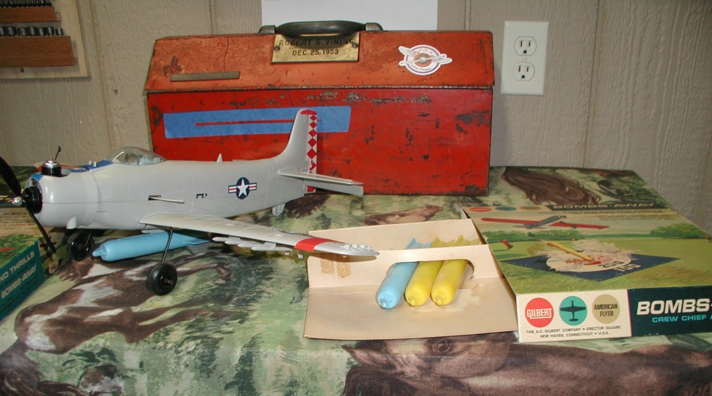

My son was over the other day and reminded me that he had found me a Gilbert "Bombs Away" set and the bombs might fit on the Wen Mac AD-6. Dug it out and they do however a bit out-sized. Same tab friction fit as found on the W/M bomb. Pull the string and the bomb drops.
He also reminded me that he had given me a Gilbert "Stooge" which might do for the P-38. Probably not, it's new in the box and I don't want to get it all castor goo so Ill be going with the catapult ramp under construction.
