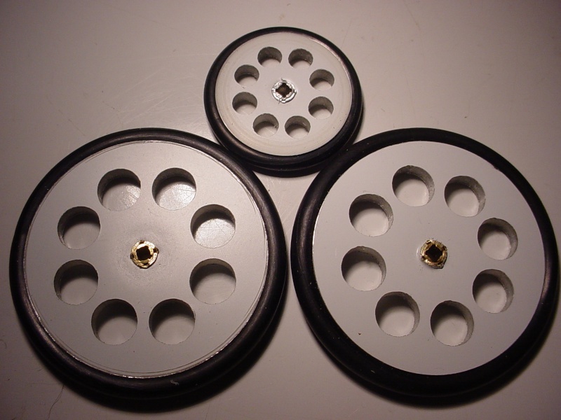

I got some odds and ends done over the last day or two. The gear struts were just pre-bent ones I had for the previous photos.. and were 5/64" (.078") music-wire. I bent-up a new gear of 1/16" (.062") wire and cut 1/16" ply-bracing for mounting to the firewall. This will make it easier for bushing the wheels I plan to use.
