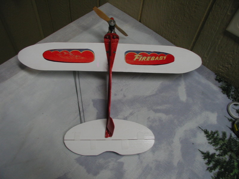

Watching television last night, it came to me why the home made Firebaby decals dissolved in water. I forgot that you have to clear coat them first. I always used Krylon clear, but for these I will try Top Flights Lustrekote clear. Krylon tends to yellow decals, hopefully Lustrekote won't.
Worked well on my Cyclone but yellowed considerably.
Hopefully the Lusterkote clear will work better on these.

Fuselage was badly twisted horizontally but fixed with a heat gun and a little bending. But it was also twisted vertically that I did not notice until I put in the horizontal stabilizer. I could mount it in a jig apply heat and twist but I don't know how the paint would react. I hate to mess with it as the stab fits perfectly now with just the right amount of tightness.
I could file the offending sides down and trim with balsa the opposing sides. Leaning toward heat and twist as it worked so well with the bend.
Not worried about adding weight to the tail as this thing is really nose heavy. I have no idea how it flew with that Silver Bee sitting out front.
Would make for some interesting flight characteristics. Normally I wouldn't care, but I'm beginning to like this wreck.
I really don't like cloth hinges, especially those I make myself, but these didn't turn out too bad.

Well, for better or for worse, it's all over except for the flying.
Standard early 350 5cc Babe Bee out front.
Yes Eric, that's what I used for the decals, lousy job of cutting them out. I positioned them several different ways, what you see is the least offensive.
I chucked up the fuselage in the vice, applied heat and twisted the tail section (horizontal stab) back into shape. Came out near perfect. Can't say as much for the vertical stab or the rudder.
Controls in ready for Freddy.

I have already started cutting out replacement parts for this model, wing, horizontal stab.
I would like to trace the fuselage and make another one from 1/4" balsa pilot silhouette and all, then attach the other parts the same way. Then use a tanked Ok Cub or a remote tank Royal Spit. Will probably do it. Heading to Hobby Lobby tomorrow.
Got to admit. It was a journey from here to there.
BTW, epoxy worked very well filling and securing those separated stress cracks, even when I removed the shims. I was not sure if epoxy would adhere to plastic well enough to do the job.
