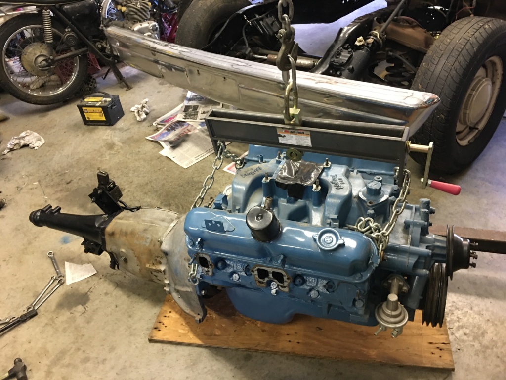

Ok, so today was a lot of fiddling about trying to get the engine mounted correctly. I knew ahead of time that the 360 engine mount was different on the drivers side, I accounted for that by making a spacer, what I didn’t realize was that the mount can bolt on fore or aft of the engine lugs. Guess who got it wrong? I didn’t figure it out until I mounted the trans bracket to the trans and came up an inch short from hitting the bolt holes. Luckily my buddy had the foresight to take a picture of how the mount brackets bolted onto the old engine. Once we figured that out after screwing around for 2 hrs we moved the brackets and it bolted right in.
Here are some pictures of today’s progress.

HA!....I should have mentioned the engine mounts,but......Mine looked that nice when I finished it in '98
...now not so much! ...but it still only has 1500 mi. on it! Looking good! That green was a factory color in 1974. Also had a '74 Power Wagon that color. Don't recall what it was called offhand.
What are you going with for carburation? Did you put in new motor mount and trans mount cushions?

I rebuilt a Thermoquad about 4 months ago and ran it on the 318 for a bit. I set it up for a 360 because I had this swap in mind. Hopefully it will run as well as it did on the 318. Yes new mounts for motor and trans.
