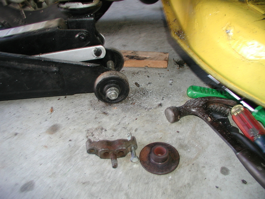

Hiatus from the RX-7. Trying to get my daughters John Deere Mower ready for the season. This thing is kicking my butt worse than any car ever did. I should just buy her a new one. So much easier!!!!!!!!!!!!!!!!!!
My Mazda RX-7GSL-SE build log with the occasional balsa inclusion - Page 8 P1015214
My Mazda RX-7GSL-SE build log with the occasional balsa inclusion - Page 8 P1015215
My Mazda RX-7GSL-SE build log with the occasional balsa inclusion - Page 8 P1015216

It's a long and regretable two day story of misery. A jacked up mower, me sitting on cold cement trying to drill out broken off quarter/20's on a level beneath my knees. Center punch the broken off bolts, and bits drift leaving parts of the bolt inside an aluminum housing. Which way do you think the bit will drift, well it takes the path of least resistance eating into the aluminum. Forget about tapping a 1/4-20.
Wound up drilling the right side hole to 3/8" and the left to 5/16" and tapping both. Don't ask why......but both are rock solid now and brakes.........got-em!

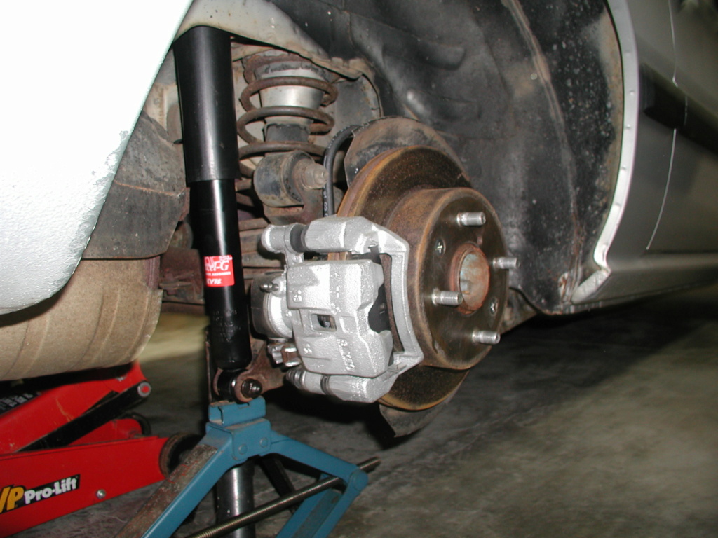

Spent yesterday driving the RX-7 and delivering the LX-172 to my daughter.  Car exceeding expections, daughter a work in progress.  Smile Smile
Proud Papa.......until the bottom falls out.  Still lot's of opportunity for that to happen.

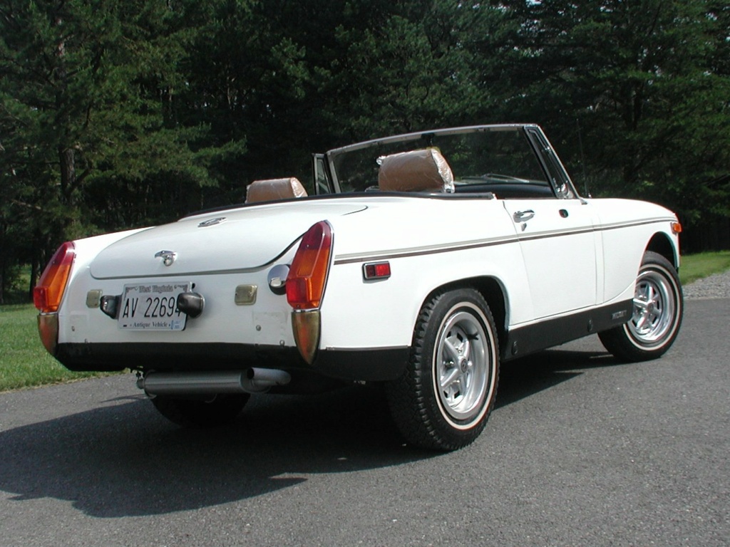

1977 MG Midget - $250.00
My Mazda RX-7GSL-SE build log with the occasional balsa inclusion - Page 8 Midget48

It's a type Rust-O Eric.  A ball of rust when I got for $250.00
My Mazda RX-7GSL-SE build log with the occasional balsa inclusion - Page 8 Mg_mid14
My Mazda RX-7GSL-SE build log with the occasional balsa inclusion - Page 8 Midget49

Rod, loved the Lucas expressions.  Got a chuckle out of each one.  My 40 year long love affair with British cars not withstanding.  Smile  Lucas - Truely the "Prince of Darkness!"
Japanese diligence and attention to detail though could not overcome the rust in the drivers side window motor.  15 years of water seepage and neglect did it in.  However the passengers side after a little lubrication worked perfectly.  I still have to remove the glass and the mechanism to replace the weatherstripping.  But the window goes up and down like new now.
My Mazda RX-7GSL-SE build log with the occasional balsa inclusion - Page 8 P1015254
But I'm not done with small electrical motors.  Both outside rearview mirrors do not remotely adjust and the windshield washer pump doesn't.
Wish I could post the video Mark took of me driving the Mazda into the garage, smooth, silent and now thankfully no smoke.
BTW, that rusty differential pictured above out of my '77 MG.  Water poured out when I drained it not 90wt.  I used a pressure washer to blast the rust out, put it back in and lubed it.  Talk about howl.  A friend (Michael Joy "The voice of NASCAR") sold me a good replacement.  Biggest expense that I had with the whole car.

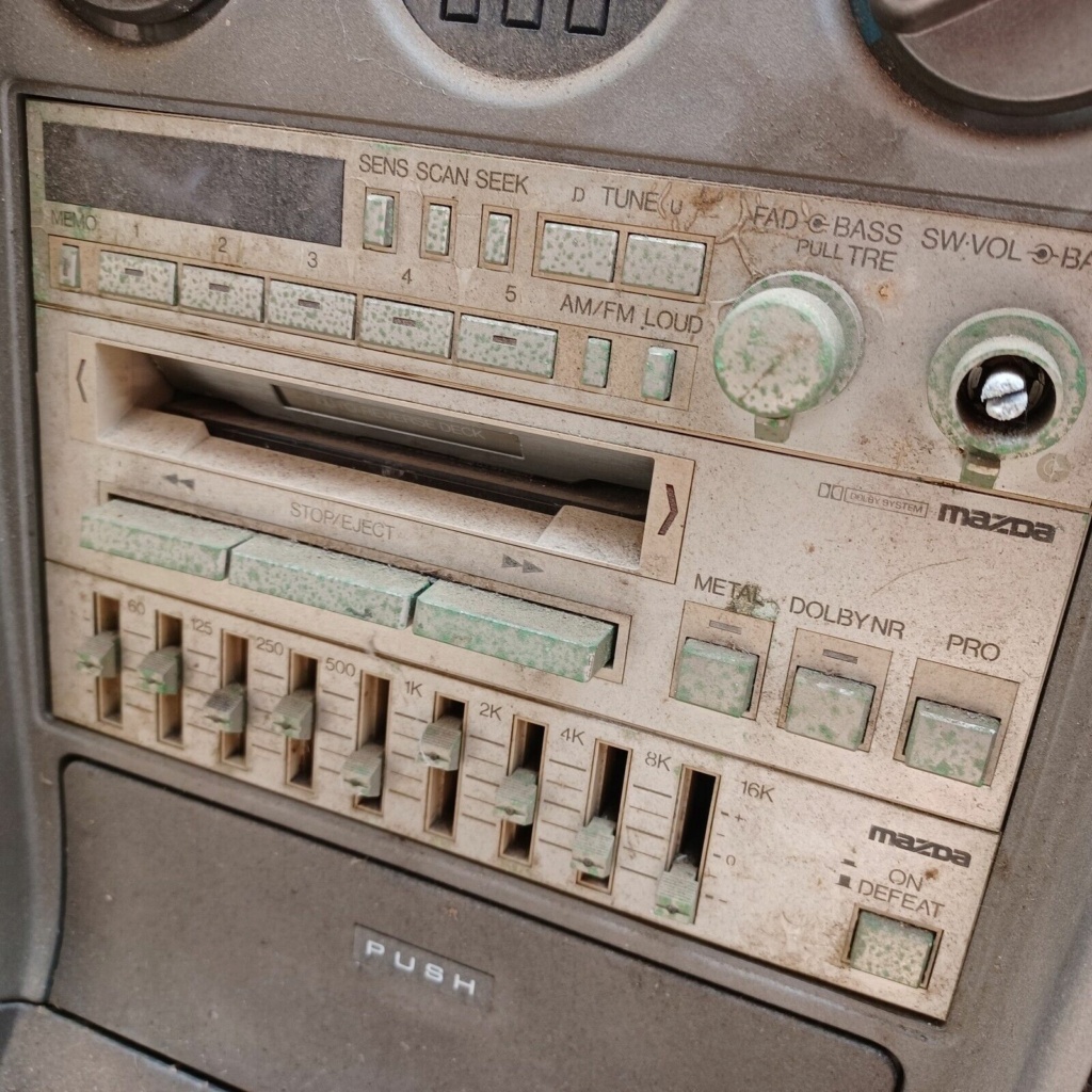

Starting to deal with the non-working radio.
My Mazda RX-7GSL-SE build log with the occasional balsa inclusion - Page 8 P1015258
My Mazda RX-7GSL-SE build log with the occasional balsa inclusion - Page 8 P1015259

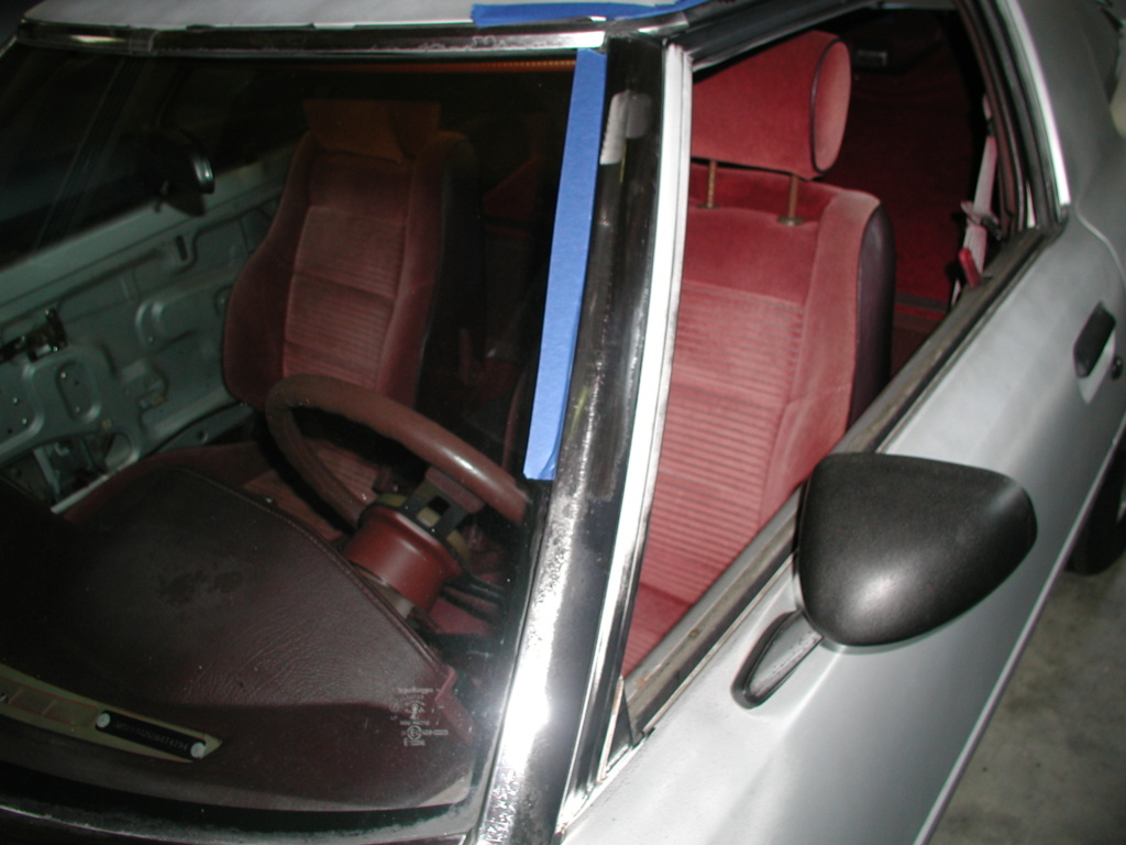

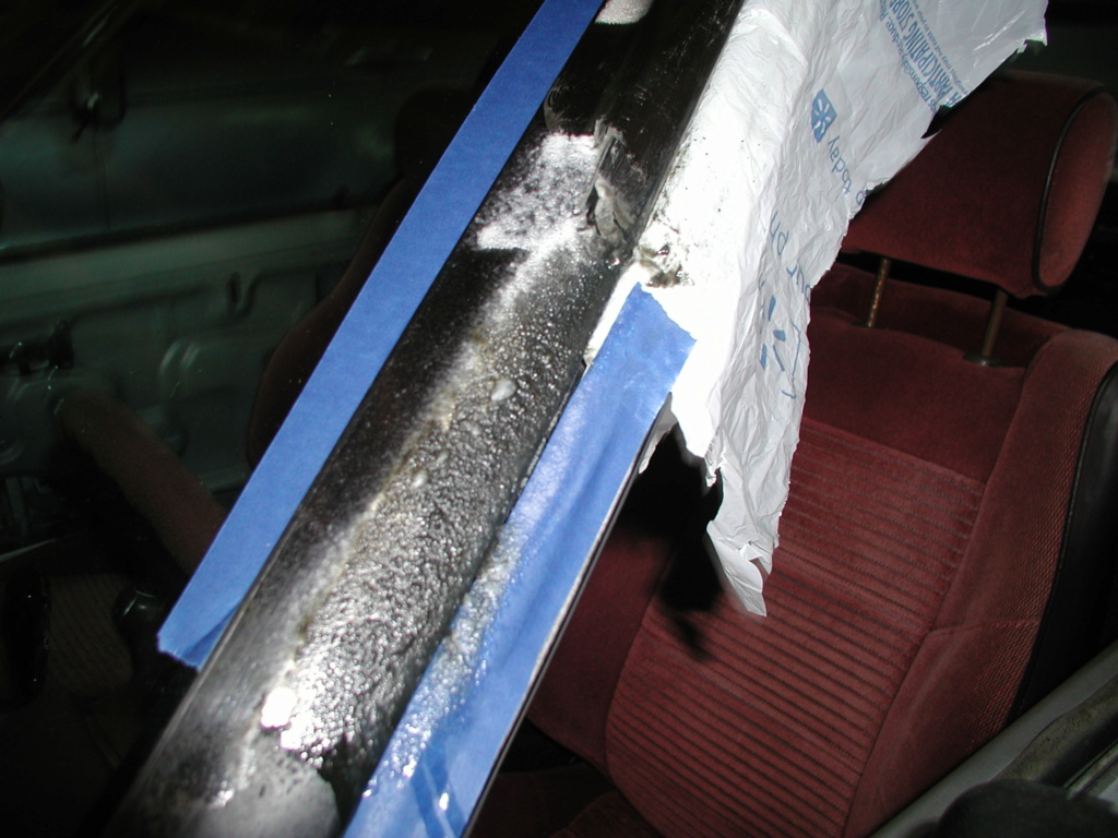

A while back I posted how Easy-Off oven cleaner removed paint from one of my plastic models.  Had the same problem with the black painted window/drip-rail trim paint on the RX-7.  Getting ready to paint...I'm doing it myself.....I wanted to remove the flaking paint covering the chrome trim.  So I went to Walmart and bought a can of paint remover at $14.00.  Didn't even touch it.  Then I thought of Easy-Off.  Within 10 minutes it had loosened the paint to where it could be removed by simply wiping with a dry rag.
Poor pictures, flash makes the chrome appear as black.
My Mazda RX-7GSL-SE build log with the occasional balsa inclusion - Page 8 P1015434
My Mazda RX-7GSL-SE build log with the occasional balsa inclusion - Page 8 P1015435
My Mazda RX-7GSL-SE build log with the occasional balsa inclusion - Page 8 P1015436
Debating whether to leave it chrome or repaint semi-gloss or matte black as original, probably paint.
Still working on it every day.  Replaced rear shocks and finished the interior among other things.
