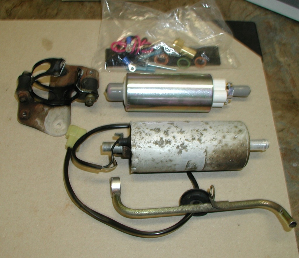

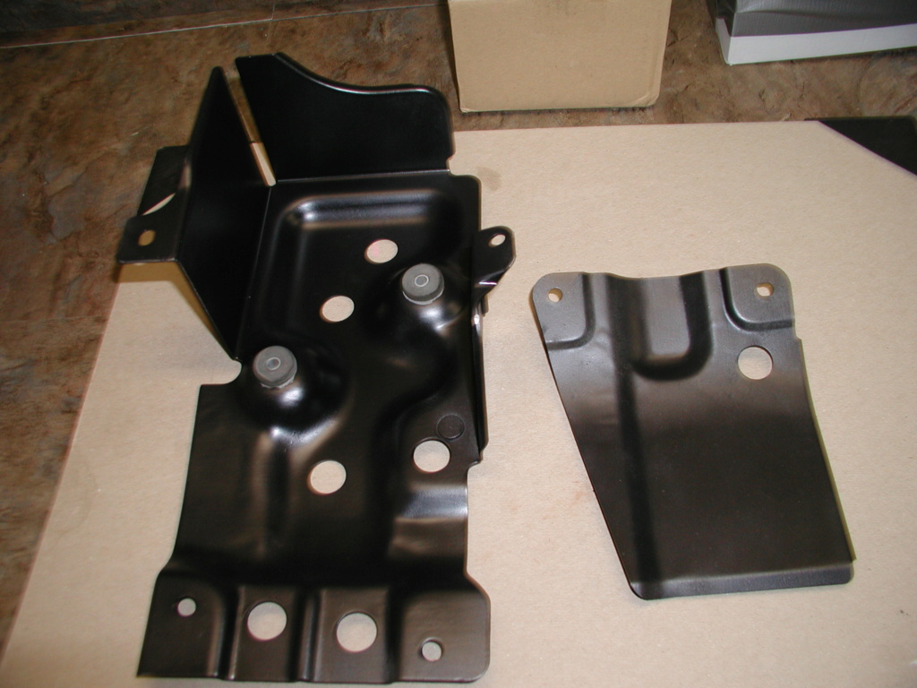

Media blasted the fuel pump/fuel filter mount and skid plate. Painted satin black. Also did the wipers. Gold, can't find the arms for less than $40 each. 17" blades with a pin mount.
Cleaned the non-working fuel pump. Originals sell for $500. Wasn't kind to it. Filled the cavity with Simple Green and flushed out many times with hot water until it flowed clean. Nothing to lose. I have a replacement after-market. $40. Going to try it again plugged in to the car's socket instead of a 12 V battery. Maybe.
Rear rotors came in. Seller sent wrong ones. Hazards of the game.
Bolt ons................

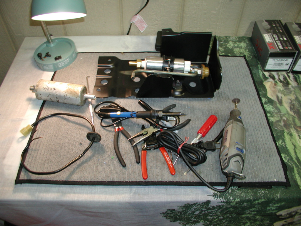

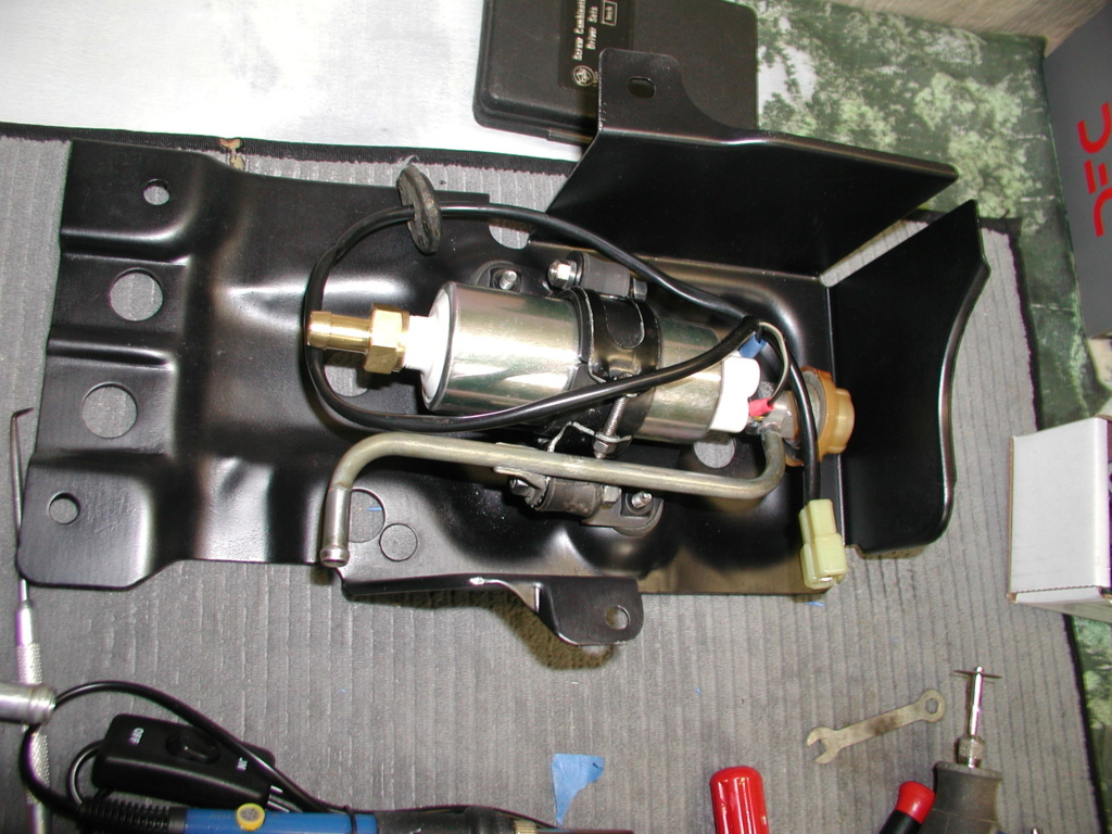

Fuel pump/fuel filter ready for install. New replacement fuel pump with the original harness transferred, using the fully flushed and cleaned original filter for now, but have an OEM replacement. Don't want to risk the new filter to any trash still in the tank.

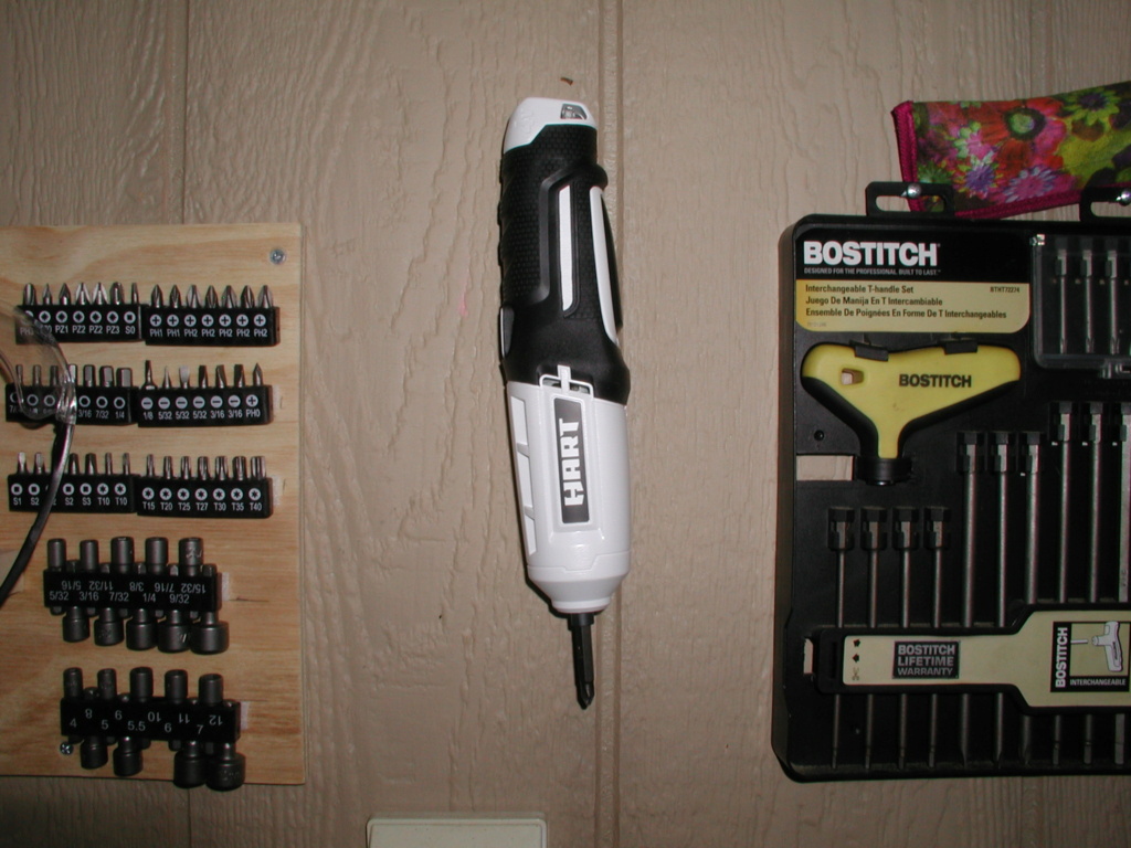

Thanks Chancey and Levent. That's a thought, I'll check in with the local Battery Mart.
That B&D is built like a tank. Perfect fit and finish and it's sealed well as evidenced by the clean interior. I thought it neat that B&D included an anti-theft strip (picture above) inside the case. It's still useful in the manual mode, and due to it's heft you can get a lot of torque with it.
