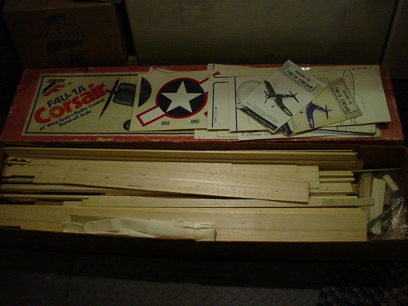

I self-motivated myself with that picture above of the unfinished Corsair. Brought it down to the dining room table, moved the Mosquito and started on it again. The previous owner had it set up for electric power so I had to modify for fuel and bearers. Hard work done now, I just mounted the engine and aileron servos. Now to finish the balsa repairs and sheet the wings.
Mosquito, finished - Page 2 Corsai10
Mosquito, finished - Page 2 Corsai12
Mosquito, finished - Page 2 Corsai11
roddie, just lay those unfinished models out on the dining room table, lot's of room and warm. Stimulates the - go get it's. Smile

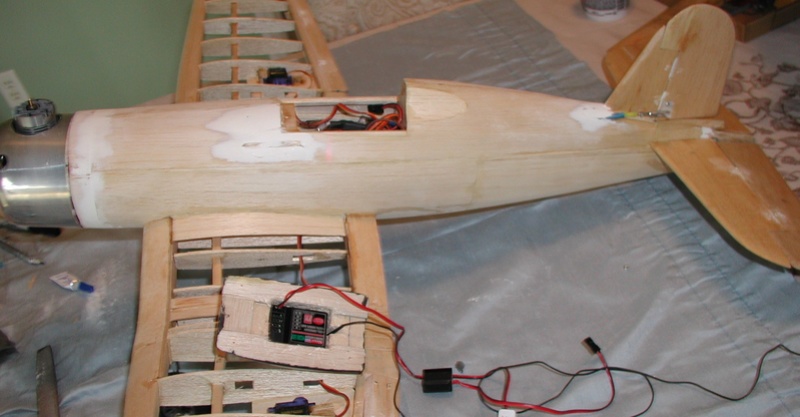

With the Mosquito finished I started once again on this Sterling F4U-1 Corsair that's been in the works for a year or two.  But I'm well on the way now with the radio, engine, controls, and fuel tank installed.
Mosquito, finished - Page 2 Corsai13
Mosquito, finished - Page 2 Corsai14
The "clown" canopy still bugs me but it allowed me to dig deep into the balsa block and hide the receiver in there.  Good thing as the available fuselage area is tight. This model was started probably years ago by someone and found at a consignment shop. There were lot's of built-in errors to correct and patching to do.
Mosquito, finished - Page 2 Corsai15
I have enough sheet balsa to plank the wing but I'm going with insignia blue monokote instead.  Easier, less weight and I will have better access to those aileron servos should one go south. Probably will use spray Lustrekote on the fuselage and tail.  Power is an OS .20, probably minimum for this model, but plenty for the type of flying that I do.

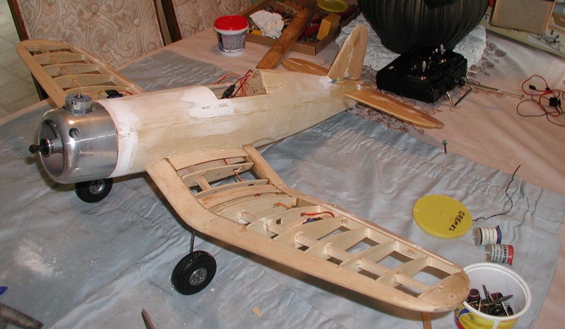

Post  rsv1cox Fri Mar 03, 2017 9:49 am
GallopingGhostler wrote:Looks good Bob, with that engine will be a hot performer.
Thanks George, I was hoping for a dog. Smile  I haven't flown RC since Florida some 12/15 years ago and have probably lost any skill that I had.  Might have to put the Fledgling in the air first.
All done now except for sand/seal/prime/paint and monokote on the wings.

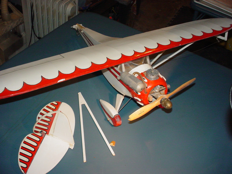

That's right George. My dad had built a Sterling Waco Cabin in the 1960's, that had an aluminum cowling. It was beige w/red trim that matched the red-head of the McCoy .19 installed. Fast-forward to the late 1980's; he bought and built a Sterling Mono-coupe that has the plastic cowling.
I wish I had photos of the Waco.. but the Mono-coupe is now in my possession. It needs a little TLC though. It has an OS FP .25 that has never seen a drop of fuel.
Mosquito, finished - Page 2 Sterli10
I like that Corsair Bob! My brother found an old (1978 vintage) Top-Flite RC kit and picked it up for me a few years ago. Unfortunately.. the cowling is missing from the kit.  Sad  It looks to be otherwise complete.. but I'm not sure.
Mosquito, finished - Page 2 Dsc02811
Mosquito, finished - Page 2 Dsc02810
I don't have an engine that's big enough for it.. but maybe it would be a good candidate for a brushless/electric motor?

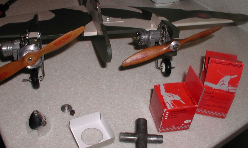

The first of the spinners for the Mosquito arrived, the plastic ones are now in customs in NY.
These are very nice, light and well made.  But the adapters do not fit the prop shaft on my Enya .09's, worse they do not fit on any of my Enyas.  I asked for 5mm's and didn't get them.
Mosquito, finished - Page 2 Enya_o10
Mosquito, finished - Page 2 Enya_o11
Little matter, I consider them to large for this model anyway.  1 1/4" would be much better but I can only find them for electrics.

Post  rsv1cox Sun Mar 05, 2017 2:37 pm
2nd crop of spinners arrived. At 1.5" still to large for the .09 Enyas and will not fit my OS .20 as the backplate is too thick for the short shaft.  Lower pitch props may fit better. They do fit my .19's and .29's but not well.  Looks like the Mosquito will go spinner less.

Post  GallopingGhostler Sun Mar 05, 2017 3:44 pm
Yes, I see that the thicker hub of the vintage Top Flite wide blade props coupled with the thickness of the spinner backplate doesn't give much room for the prop nut to properly thread on the shaft. I suspect a similar problem with the Sterling 36" P-38 profile, too. Photos on the box show it as being spinnerless. Of course on this model, it would be as a spinner nut versus a hub enclosing spinner.
