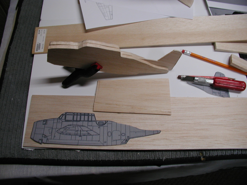

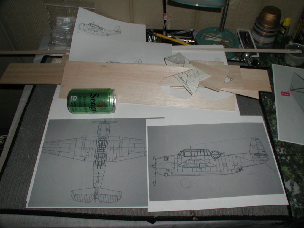

My intent is to build it along the lines of the original, center line 1/16" balsa and side-boards incorporating the rear downward line (see Avenger drawing) of the Silver Lining with the side-board - profile like.
The Ginger Ale can might be a bit large (Cox .010) so I will probably use the V8 can instead, besides it's better for ya. I'm going to play around with the size, but probably will just cut out the illustrations and lay them on balsa.

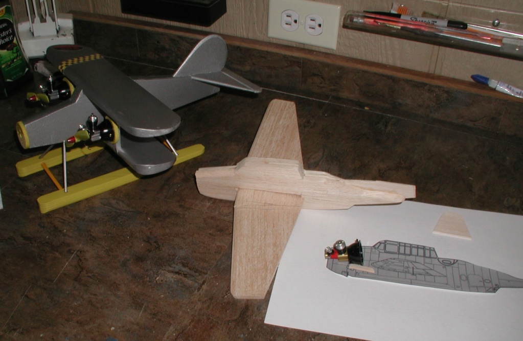

I keep messing with the things. Wing will be simple, diagonal cut off the center section and a little dihedral on the ends. Fuselage, cut out the center section balsa leaving just a frame, sheet with 1/16" balsa. Probably a better way to do it but at this age I'm not a stick and paper guy.

I could have built it twice as large and that little Cox would still pull it around, but I wanted to maintain the original "Silver Lining" size and theme. I did make the wing larger than the picture both in length and chord. Just doesn't look it.
Is it possible/advisable to lay the .010 over on it's side at 90 degrees? Anyone ever done it?

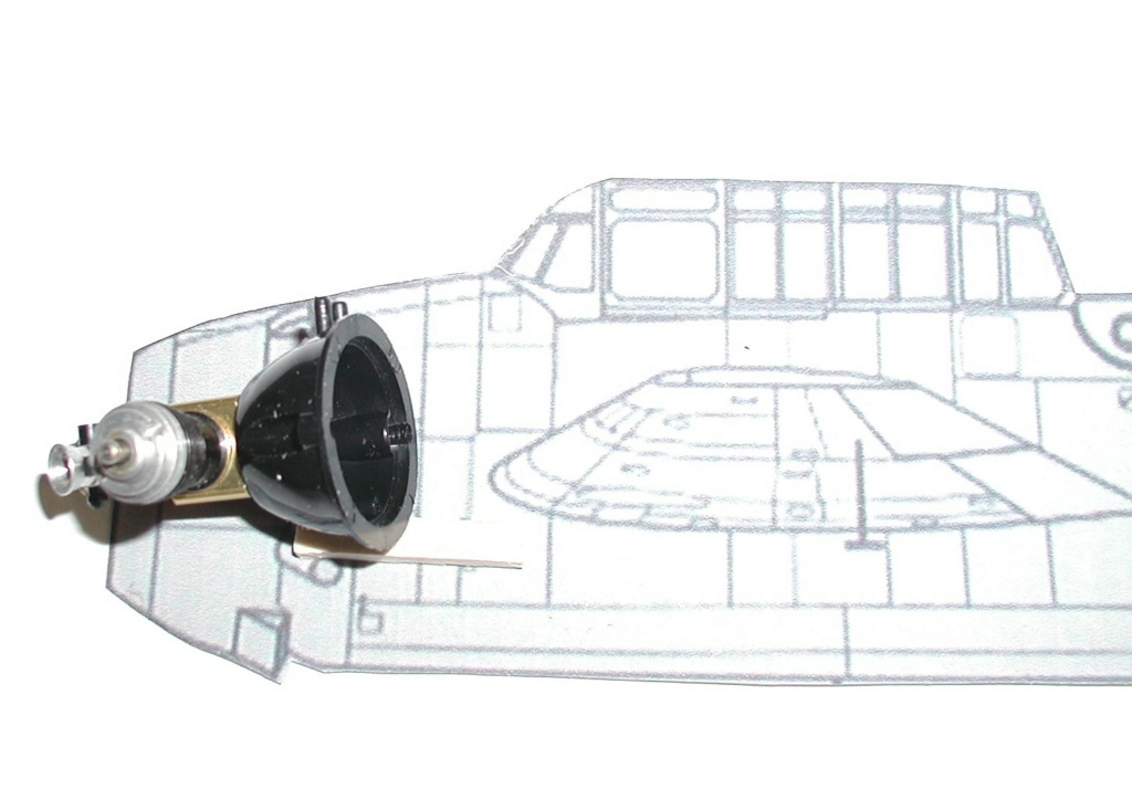

To answer my own question, yes you can lay the .010 over 90 degrees but you have to do it on the inboard side to maintain the fuel pick-up in the proper position. Outboard side the pickup is way to high. Also to mount it on a firewall you would have to remove the cylinder to screw in the top mounting screw. Not sure what I will do, but the side mount has it's advantages in this application.
Edit.....Scratch that, either orientation will work inboard/outboard but the cylinder will have to be removed to mount.
