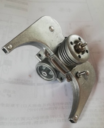

Another nice touch from FedEx. Found this photo while checking on the tracking number. Delivered to my garage door, they provide a picture.
Nicely packed, not crushed and on time from halfway around the world. Sosam knows.

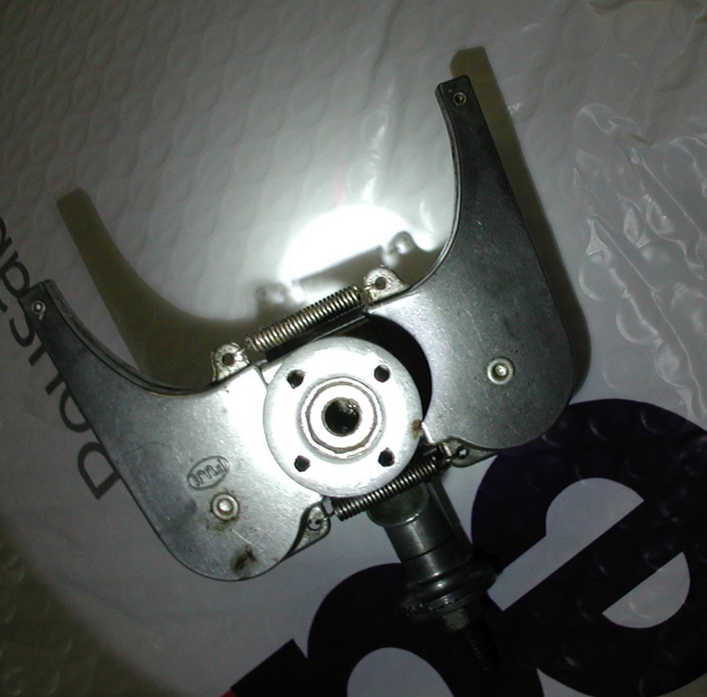

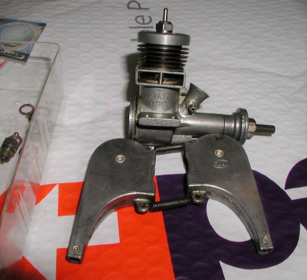

Very clean, might have been treated with a preservative, locked up tight, tool marks on the drive washer, missing glow plug replaced with one from burned-out drawer. Tried to get a picture of the head screws. Look smaller than 2/56's - metric equilvalent probably. Tiny thin straight slots. Jeweler's screwdriver only. I don't think I will be able to remove them but going to give it a try. Drive washer will be drill press chucked up and remove the tool marks ..........carefully. Some heat and a little light oil will free the piston.
Nobody here seems to have much experience with Fuji engines?

That Fuji engine is very cute, with its Batman wing-like mufflers that may also add a bit to the aerodynamic lift of the plane's wings..

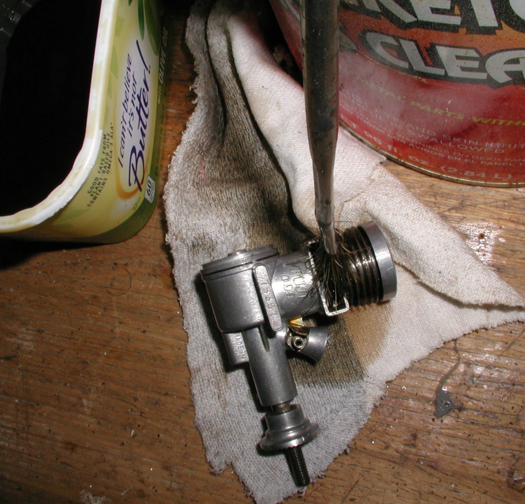

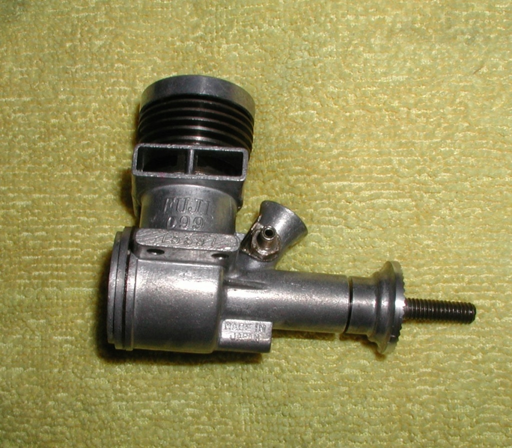

Totally beat yesterday from working in the woods, sore back, sore jaw from tooth extraction, headache. But still, I have a fresh engine to investigate.
Added to this:
https://www.coxengineforum.com/t17366-batwing-fuji-099

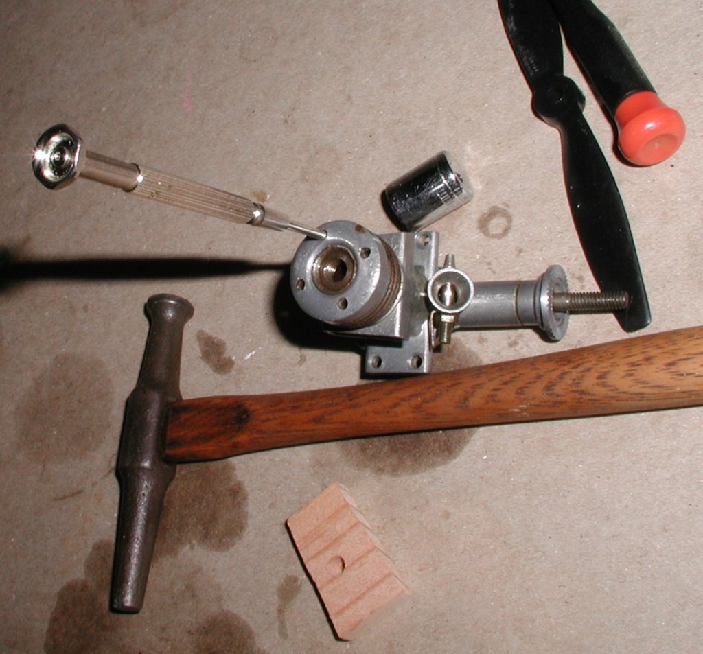

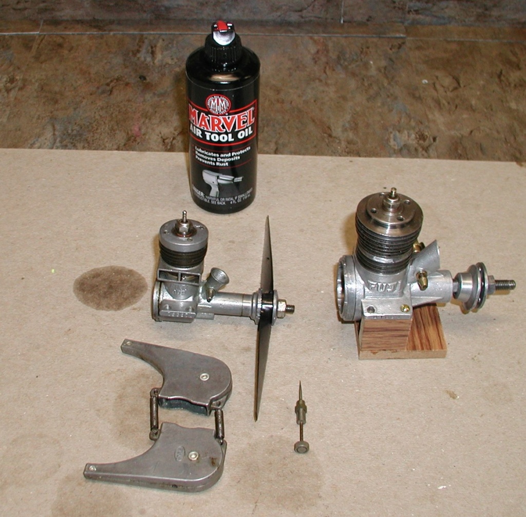

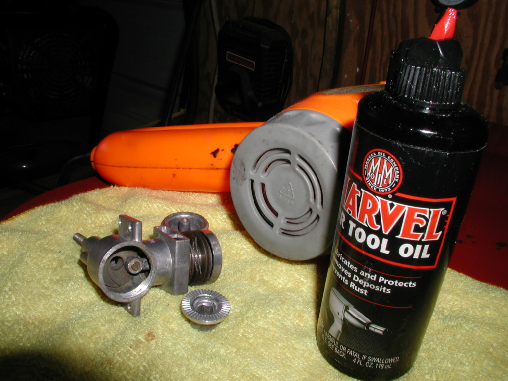

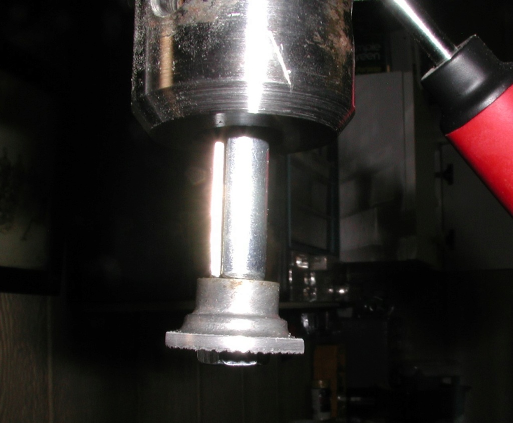

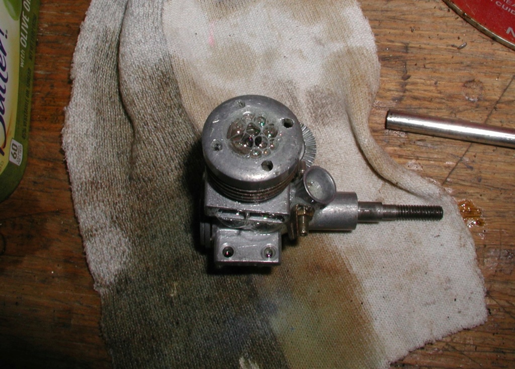

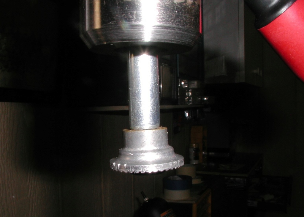

So last night I headed to the basement. Heat gun, MMO. I had to drill out a Cox prop to fit the Fuji's shaft for use as a pull-through. But first I had to get the prop nut off. PO had run the nut up on the unthreaded shaft and would not budge. I had to use toothpicks through the exhaust ports to free. Chewed them up pretty good and left a part of one (perfectly shaped) in the cylinder that I had to blow out with compressed air.
Heat, MMO in the glow plug hole, exhaust ports and intake got the shaft moving......with effort. More MMO at the interface between the drive washer and case and openings but still a whole lot of drag. Brown goo appearing, this thing is loaded inside with castor and will have to be disassembled. Clean on the outside gummed up on the inside. Delt with this before, and disassembled. But, there is an option if I can't get the head off.

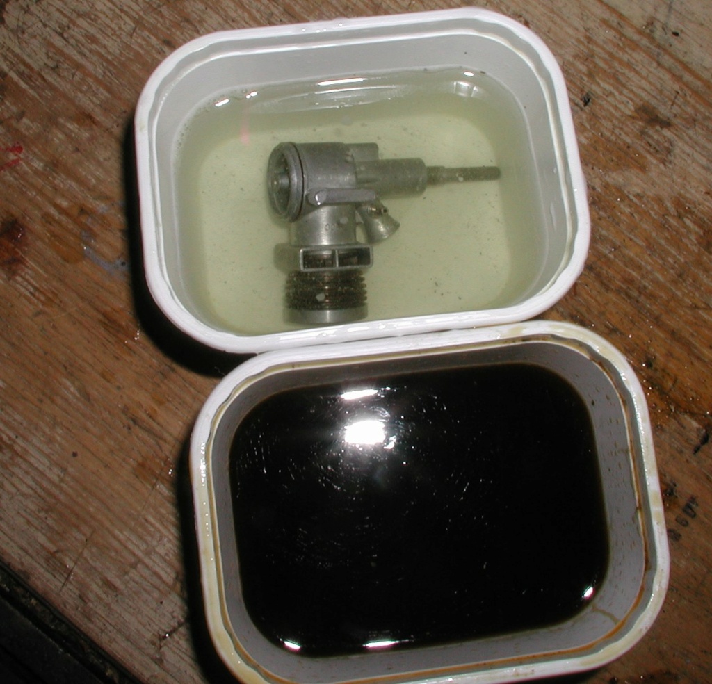

I have had excellent luck before by immersing a warm engine in Berryman's and with the intake and glow plug openings free turning the engine over both CW and CCW many times, then flushing out with hot water and Simple Green, then just hot water until it runs clean. Then blow out with compressed air, heat until dry then oil with RemOil or MMO. Saves taking it apart when they won't come apart as may be the case with this Fuji.
But, the good news is, the fuel tank from the Ok .099 is a perfect fit, I just have to find the proper length screw.

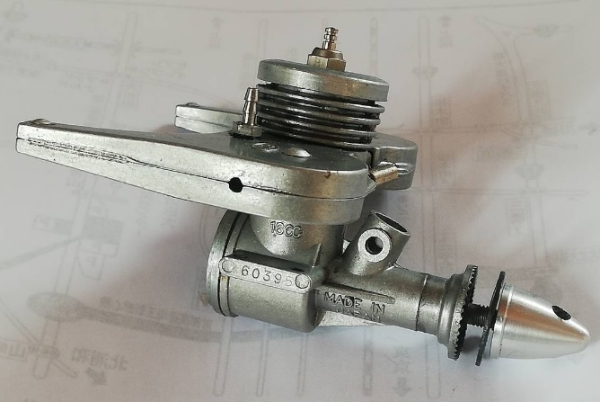

Last year I bid on a group of engines (mostly Enya) that was on the Yahoo (Japan) auction site (as JUNK).
It was a group of Enya .049, Enya .06 / a Enya .08 and one Fuji 1.6cc.
Total was seven Enyas and this one Fuji.
Cost for the "eight" engines were $150.00 (before shipping cost)
The seven Enyas --- JUNK before rebuild:
And the "ONE" Fuji 1.6cc Jr. (I have cleaned and rebuilt)
Learned a lot on that Fuji engine on how to carefully take it apart.

The Fuji is an interesting engine Vs. Enya engines (like buying either a Ford or Chevy -- matter of taste?)

I tried the machine screw (4/40) from the OK Cub. It works and tightens but still seems a bit sloppy. Will be looking for the size that sosam suggested.
I had to swap the NVA to the left side to fit the OK's fuel tank, the Fuji bleeding MMO the whole time. Still stiff, it will get the Berrymans treatment. No worries about compression, even while stiff it gets nice resistance at TDC.
Notice the flats on the cylinder fins.

Broken fins on the back Bob, makes me think it was a victim in a crash. A nose in that broke the hardwood mount and shoved the engine into the bulkhead firewall. Those thin steel fins of mild carbon steel, wouldn't take much to break them.

Thanks George, I was afraid that they were broken fins, but they broke clean. No reason for flats there.

Gave the Fuji the Berrymans treatment this afternoon. Amazing the difference it makes. Crock pots and A/F are so yesterday for me. Three minutes in Berryman's rotating the prop shaft CW and CCW and this is a new engine. Just put it back together and it has that nice new Cox .049 compression pop and back snap. Zero drag on the shaft. Some difference.
Shaft/drive washer are not splined rather a flat, a reason it came off so easy. Before Berryman's and after.
Before and after drive washer, chucked it up in the drill press and a very fine jewelers file removed 90% of the damage. Later I smoothed it out with crocus cloth.
Thought about modifying a socket per sosams idea, decided to wait until after a Berrymans' soak. Glad I did. (Didn't need to..later) Jewelers screwdriver only "settles" into two of the four slots, not good for disassembly.
Berrymans, Simple Green in all the cavities, hot water rinse. Compresser blow out. Heat gun dry. Marvel Mystery Oil.
While blowing out the water with compressed air I noticed water bubbles coming out around the backplate. What? Loose...yes! I just unscrewed it, no need to modify a socket.

Gave the mufflers the Berryman's treatment and built a stand for it. I'm happy with how both the simple stand and the engine turned out. No reason why it would not run with the proper glow plug. I would run it without the mufflers, added weight and complexity would be a bother.
I have been looking around for a plane that would fit it. Nothing I have in my mind built or kit would be a good fit. ,099's are a new breed to me. Perhaps a Tiger Moth. I'm open to suggestions.

Bob, your "Bat" Fuji .099 cleaned up well, looks impressive, love the odd styled muffler, would add class to the front of any classic model of the era. Regarding a type of plane for it, just bought a reasonably complete kit, an old 25 in. wingspan C/L Scientific Cessna 170 profile, should be here soon.

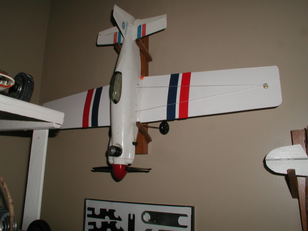

It is for my similar class power Fox .09 Rocket complete with tank. I am amazed that this Scientific actually has symmetrical wing ribs.

The bat wing Fugi turned out nice Bob…. Certainly a unique shape…. Whatever you put it in needs to highlight the mufflers…. They could form the top part of the cowling with a little block balsa work….Maybe consider to copy the 170 below?
The 170 is neat George…. I like how Scientific (Musciano?… Looks like his work) went to trouble to cowl the engine on a profile fuse…. Maybe not the most practical but certainly adds character…. Wheel pants too!! ….. Will make a nice 50’s style CL…. Very unique

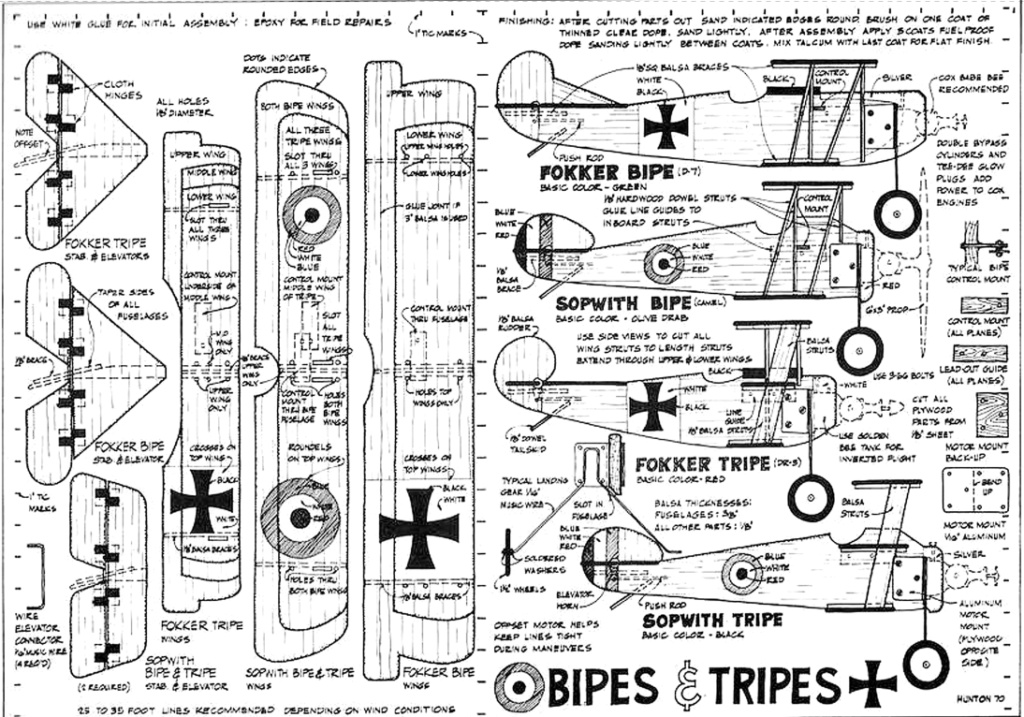

Bob, there is a half-A plan on Hip Pocket Aeronautics that could be scaled up a touch for that Fuji:
https://www.hippocketaeronautics.com/hpa_plans/details.php?image_id=312 WWI Bipes and Tripes
