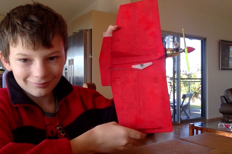

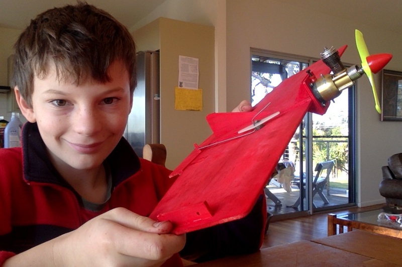

heres the little beauty about a week ago a package from fred arrived in the box of engines and props i found this a black hawk models 2 for1 lil combat kit here's the finished product
my first cl plane! Photo_15
my first cl plane! Photo_16
ps i painted it RED to MAKE IT GO FASTER!
than jacks which is blue he has a black widow on his Babe Bee
so today i'm going to fly it at the cricket oval any tips' n 'tricks?

Greg,
Does the engine have any offset? Hard to tell from the picture. You want it to pull away from you when you fly.
What are you planning on using for lines and leadouts?
Happy Re: my first cl plane!
Post  Oldenginerod Sat Jul 25, 2015 11:38 pm
Also Greg, I would recommend turning the bellcrank around to save tangling up with the pushrod during up elevator. Also sharpening up the bends in the pushrod to a full 90° will give more reliable & freer movement.
I see you're still trying to trick us with the back-to-front photos lol!

Oldenginerod wrote:Also Greg, I would recommend turning the bellcrank around to save tangling up with the pushrod during up elevator.  Also sharpening up the bends in the pushrod to a full 90° will give more reliable & freer movement.
I thought that all of you folks from the "land down under" rigged your bell cranks that way. Smile

Good idea. Those Bats are Not easy planes to fly, especially if the engines are at less than full power. Luckily the instructions recommended C/G(1" from LE)is too far forward, so they'll be slow to turn and will barely do loops even if you use the whole sky. It could not even remotely fly a combat match like that.
As-is, however, they will fly flat laps pretty easily. Launching is a bit tricky. Make sure your pit mad holds it with the lines tight, pointed up and out. Do not toss, just have him let go and step out of the circle immediately. Wayne let go of mine today and it immediately flipped over and missed him and my first full lap was inverted. Lol. It was a real crowd pleaser, but dangerous and unplanned. So hold the elevator neutral while launching.

From looking at other posts I have seen that the other bats have a tilted tails and I see that yours don't have a tilted tail, maybe you should check with rusty that the tilted tail is right.

Here's a picture of Rusty's Bats.  See how much the tail fin is angled?  The plan makes it pretty clear where it should go.
my first cl plane! Lil_ba10
This is mine.  Also, for Greg, note which way the bellcrank is pointing.
my first cl plane! 100_1612
Jack, I think Greg said he used dope under the paint.  Otherwise, the fuel will disolve the paint and soak into the balsa.  Even still, if it's normal spray can paint it will need to dry for a couple of weeks or the fuel will just wash it off.  I can guarantee you, you will spill fuel and you will end up with a mess on the plane.  The important thing is to clean it off as soon as you can.  Once you run the engine and get castor oil on the paint it will be hard to make more paint stick.

I just had another look at the picture of Greg's plane. The push rod is in the hole closest to the elevator. That will make it really hard to keep steady. It should be in the hole furthest away (the very top one) so that the controls work a bit slower. That will make it easier to learn.

Cribbs74 wrote:Greg,
yes i have just put them on i did'n fly yesterday because it was too windy and also one of the old guys from the club is going to help me

Post  cox24711 Sun Jul 26, 2015 10:10 pm
on the engine don't have any offset because it didn't say about any in the plans do i put any offset on?

AUjack2003 wrote:Greg
Jack
This Site Rocks!
jack the a tail is tilted

Post  NEW222 Sun Jul 26, 2015 10:12 pm
I am not too sure here about all of this, but I have to ask. Are you planning on flying in a clockwise circle? To me, the plane does indeed look set-up to fly that way. If so, the tail does appear to be angled outwards to the correct size then. This is of course by the pictures as I see them.
Posts : 3847
Join date : 2011-08-14
Post  NEW222 Sun Jul 26, 2015 10:13 pm
Oh, and also, I do agree with the other post and flip the bellcrank over. Would be easier and better for control.

Post  cox24711 Sun Jul 26, 2015 10:14 pm
NEW222 wrote:I am not too sure here about all of this, but I have to ask.  Are you planning on flying in a clockwise circle?  To me, the plane does indeed look set-up to fly that way.  If so, the tail does appear to be angled outwards to the correct size then.  This is of course by the pictures as I see them.
yes colck wise and the tail is angled sight ly like the purple one maby more

Oldenginerod wrote:I just had another look at the picture of Greg's plane.  The push rod is in the hole closest to the elevator.  That will make it really hard to keep steady.  It should be in the hole furthest away (the very top one) so that the controls work a bit slower.  That will make it easier to learn.
ok ill do that This Site Rocks! !

Post  gossie Sun Jul 26, 2015 10:33 pm
Pic is mirror image. lol!

Post  Cribbs74 Sun Jul 26, 2015 11:53 pm
cox24711 wrote:on the engine don't have any offset because it didn't say about any in the plans do i put any offset on?
I'll defer to Rusty as I see his don't have much (if any) either.
If it were mine I would, but it may not need it.

Pack some washers, or make some wedges prior to flight day. Washers could be used under the inside mounting ears, but the wedges are more secure.

Post  pkrankow Mon Jul 27, 2015 1:16 am
cox24711 wrote:that idea bring them just incase
Might not need them, but they will be in your box if you do. Bring some extra screws too. Drop one in the grass an there is no finding it.
