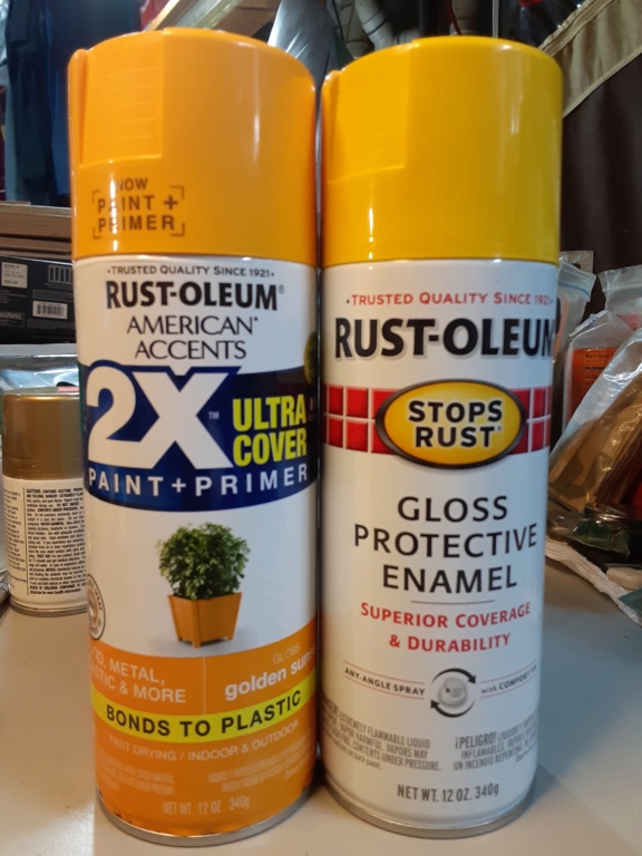

Thanks Robert, It's more of a "taxicab-yellow".. than a canary.. or lemon-yellow.. but I do have both.
T-Bee-D1 (a Rod-de-sign) - Page 7 Rust-o10
T-Bee-D1 (a Rod-de-sign) - Page 7 Rust-o11

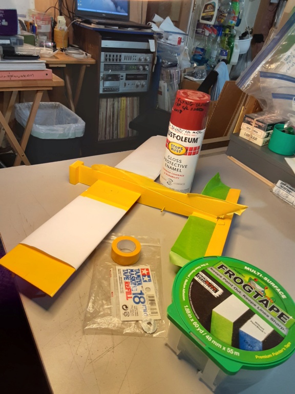

Too cold outdoors to paint. I can't paint indoors here at home.. because there just isn't proper ventilation. I hope to be able to spray the final coats in the warehouse where I used to work. Stay tuned.. Smile

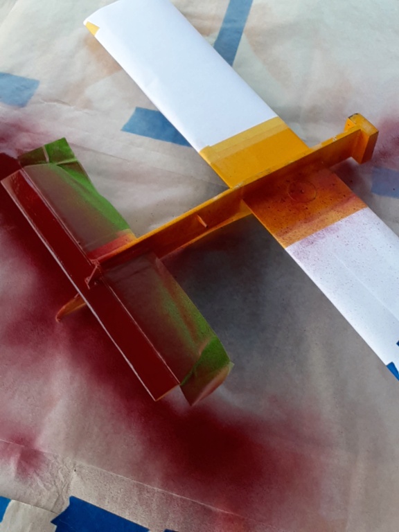

Looks like no one will know the look that I was going after..... because the can sprayed for one second.. then died.. DAMMIT! Mad DAMMIT! Mad Crying or Very sad
It was 52 degrees F. and sunny this morning when I woke up. By noon time it was 60. I was psyched.. because I didn't think I was going to be able to paint until possibly next Spring.
.... so I get all set up....
T-Bee-D1 (a Rod-de-sign) - Page 7 20231146
.... and start to spray my maroon color.... and this is how far I get....
T-Bee-D1 (a Rod-de-sign) - Page 7 20231145
.......... I thought maybe the nozzle was clogged.... no. There's almost a full can..

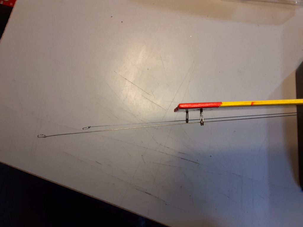

I have to ask, what is going on with these lead-out guides? What happened to the wire lead-outs? I must have missed a page.

rsv1cox wrote:I have to ask, what is going on with these lead-out guides?  What happened to the wire lead-outs?  I must have missed a page.
T-Bee-D1 (a Rod-de-sign) - Page 7 Roddoe10
I'm still using the solid-wire lead-outs Robert. I removed most of the control linkage prior to painting. The tip-guides and pushrod fairlead I covered, using pieces of  sm. plastic tubing.
T-Bee-D1 (a Rod-de-sign) - Page 7 20231152
I kept it simple..
T-Bee-D1 (a Rod-de-sign) - Page 7 20231153
You can really see that outboard tip-weight now...

Ah, paint protection roddie.  Got it.  Your attention to detail, I would have just painted right over them or added them later.

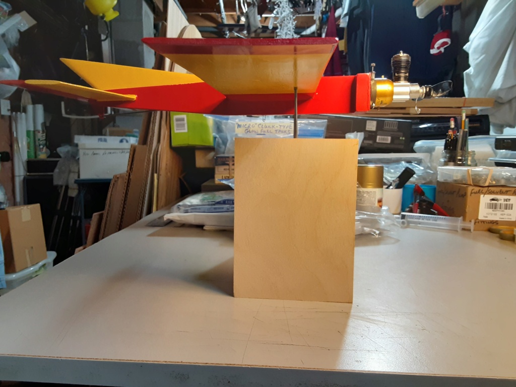

I decided to reinstall the controls. The lead-outs need shortening. I made them long to test how small I could form the eyes. I wanted them small enough to fit through my safety-pin/guide-eyes.
T-Bee-D1 (a Rod-de-sign) - Page 7 20231155
The pushrod fairlead worked out well..
T-Bee-D1 (a Rod-de-sign) - Page 7 20231154
weight "less-engine" is 4.5 oz.
T-Bee-D1 (a Rod-de-sign) - Page 7 20231156
"with-engine" will be 6.6 oz.
T-Bee-D1 (a Rod-de-sign) - Page 7 20231159
I made new balance-posts using finish-nails..
T-Bee-D1 (a Rod-de-sign) - Page 7 20231160
Balancing approximately 13/16" rearward of the wing's leading-edge.. with the 8cc integrally tanked engine (much the same as a Golden Bee)
T-Bee-D1 (a Rod-de-sign) - Page 7 20231161
